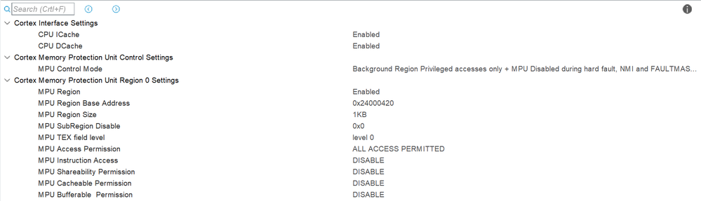

ALIGN_32BYTES (static uint8_t uart_buff[UART_RX_BUFF_SIZE]);Then as I am working on a cortex M7 I have declared a "free" zone at the address of my buffer for the DMA to access it :

You have to manage D-cache:
Alternatively you can use MPU to configure non-cacheable region. For quick testing purposes just do not enable D-cache.

2022-05-16 5:40 PM
@QLeco.1 Also, the base address of a MPU region must be aligned on the region size.
You've defined a region with size 1KB at 0x24000420.
The cube should validate the MPU settings better...
