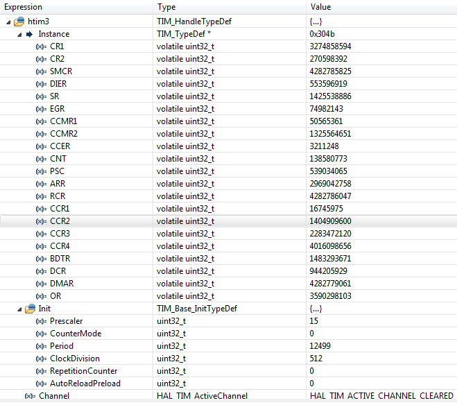

I am working on STM32F413VGT with STM32CubeIde.
I am using timer 3 channels 1 and 2 to generate 2 PWM signals to control a motor. This part works perfectly.
I am also using ADC1 in DMA mode to get 7 ADC measurements. This function also works perfectly.

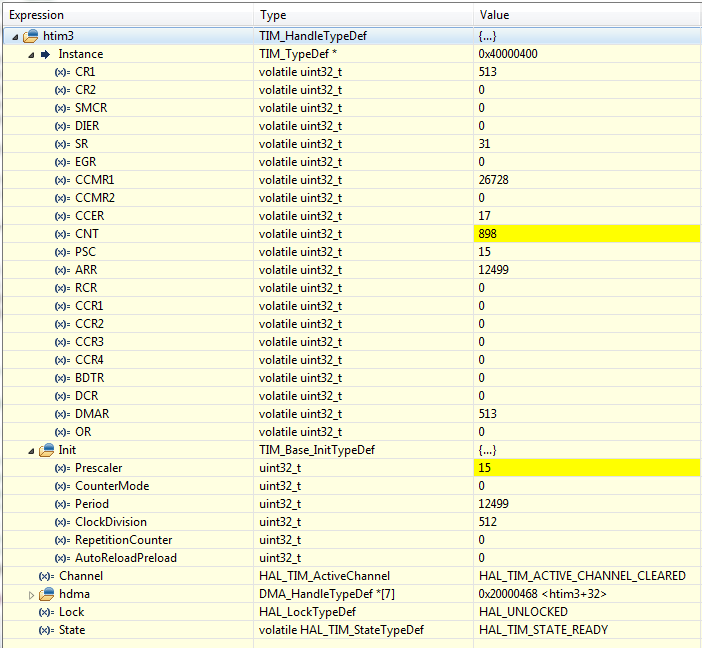

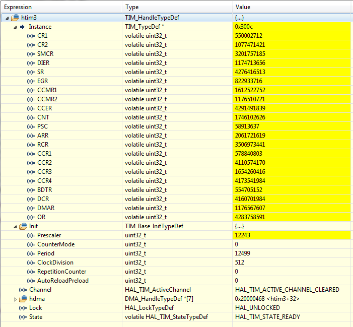

I can change the PWM value with UART command or GPIO. But, when ADC measurement and PWM signals are both in my software the PWM signals freeze after some minutes and I can't change it. Instance and Init value of this are changed when I check on STM32CubeIde. (timer3_ok and timer3_ko)
Do you know why I have this problem on timer3 when ADC is used ?
I don't have this problem with an other timer or when the ADC is not present. I have just this error with the timer3.
I tried to generate a PWM signal with TIM1 CH4 and TIM2 CH2 and no problem...
I also tried to use ADC1 without DMA but I also have the same problem.
Parameters with timer3 OK:
Parameters with timer3 KO:

2020-07-17 5:40 AM
Looks like a buffer overrun is writing over htim3.
Show the code you use to write ADC values via DMA. My guess is the problem is there.

The time when the value get changed vary between some seconds or some minutes ...
In my last bug only the Instance value changed, the Init value are correct :
Tom,
