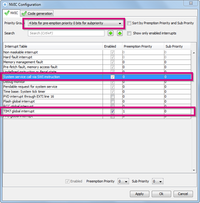

2016-12-08 6:35 AM
The priority -1 on systick is taken in care only when the two interrupts have same settable priority.
By default in CubeMX the Systick is set to 0.
If you are using the CubeMX project please check the systick an tim7 priority in the project and the group priority option.
If the group priority do not have any bits for preemption priority then the interrupt cannot preempt second active interrupt.
If you are not using the CubeMX please check the HAL_NVIC_SetPriorityGrouping and HAL_NVIC_SetPriority functions if they using correct priorities for systick and tim7 and correct group priority.

2016-12-08 6:35 AM
Best regards
Radek
2016-12-08 7:21 AM
Thanks! Thats it.
I wrongly mistook the index in the interrupttable as the priority:(
It's working like a charm now. Thanks again.
