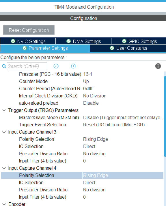

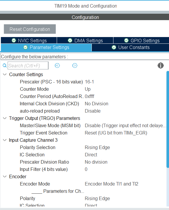

I have enabled encoder and input capture and only encoder works.
The reason is that CCR3 and CCR4 is zero.
HAL_TIM_ReadCapturedValueWhy does this happen? I have enabled NVIC for TIM4 and TIM19 and HAL_TIM_IC_CaptureCallback is called when the Input Capture get a rising edge, but still, CCR3 and CCR4 is zero. Why?

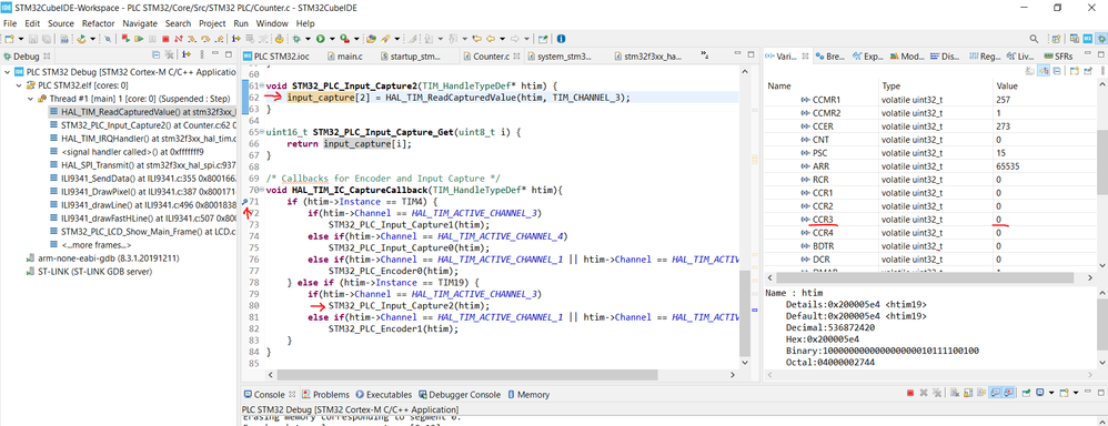

Here is when I am in the debug mode.

CNT is also zero. Seems reasonable that the input capture was triggered when CNT=0, which would lead to CCR3=0 as well. What value are you expecting it to be?
Not sure if encoder and IC can be used simultaneously, but if they can, they share the same counter.
2021-06-21 11:39 PM
Yes it can, and, as you've said, it captures the value counted for the encoder. For time measurement, another timer has to be used.
Also, nonzero prescaler in encoder mode leads to nonsensical readings.

There is only one counting element in one timer. You either use it for the encoder, or for measuring time, can't do both in the same timer.
2021-06-22 4:25 AM
So the reason why I'm getting CCR3 = 0 all the time, is because I'm using the Encoder at the same timer.
