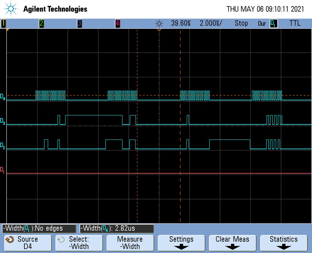

The problem is that between each two complete cycles (8 periods) of SCK signal, the SCK line stays idle without reading any data. With longer streams of data, the acumm delay is bigger so it's a problem. In my application, the SPI TX/RX is critical and execution task time must be as short as possible.

As you can see inter 2-byte space is 2.82us while SCK clock is 120ns period, Im wasting too much time.

There is another stranger issue... when I just transmit with HAL_SPI_Transmit() function these delays completely dissapear.

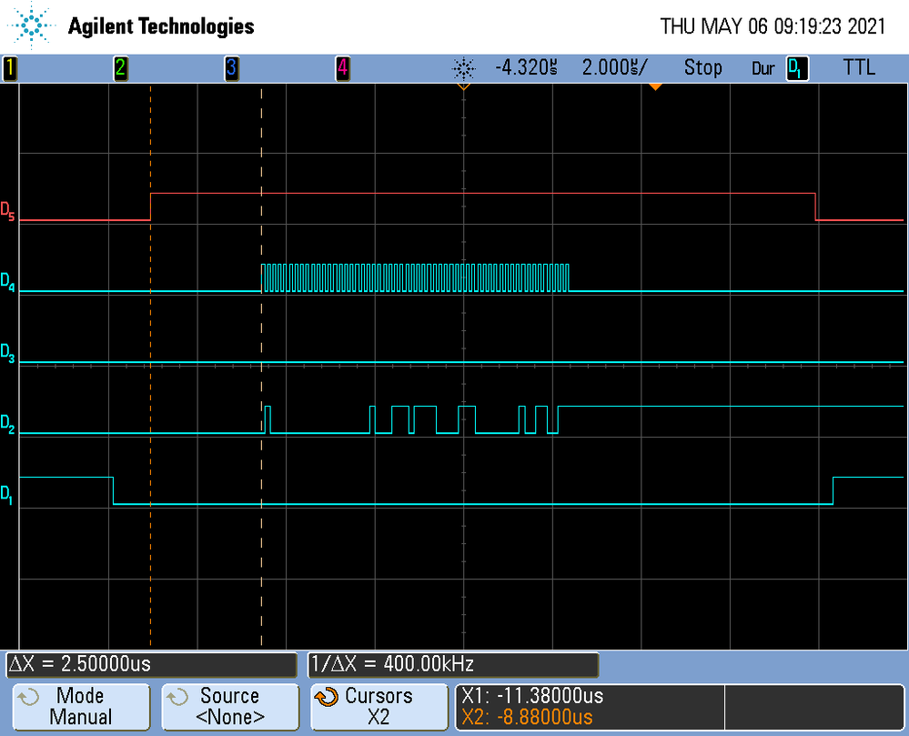

D5-->GPIO measuring HAL function execution time
In a future post I will ask about why Im losing 2.5us between start of HAL_SPI_Transmit() execution and first SCK cycle or 5.54us between last SCK and end of mentioned function execution...
