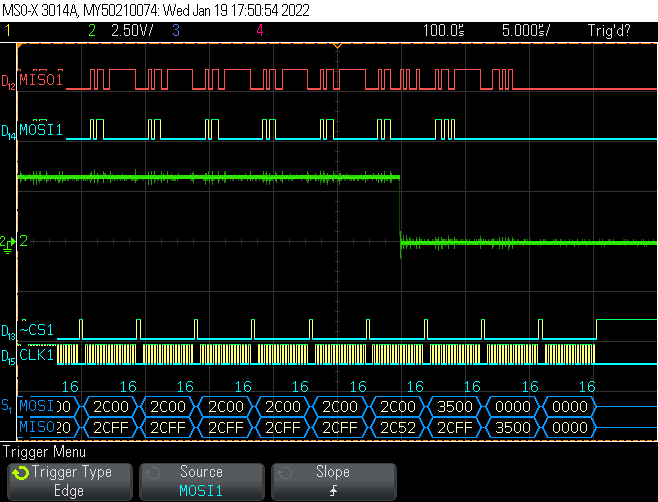

I have attached 2 images.
image1 shows the final words on my osciloscope.
image2 is the reciever buffer memory after the the dma finishes.
- For the last 3 response Bytes I expect 2CFF , 3500 , 0000
- The osiciloscope shows that they are indeed 2CFF , 3500 , 0000 (attached image 1)
- But where I would expect 3500 I get (seemingly out of nowhere) 2C00 in the response buffer
- 3500 and all following answers are shifted 2 Byte "downward" (attached image 2)

- the last response does actually get cut off. If I send a different sequence (where the final reply is not 0000), the final reply does not get written into memory.
- the error allways seems to be on the 25th 16bit word, when i lengthen the transmission the same issue happens on the 25th response, 2C00 appears seemingly out of nowhere, the consecutive responses are shifted 16bit backwards and the last one is cut off
- all 26 16 bit words are sent with a single call of HAL_SPI_TransmitReceive_DMA, and for the first 24 responses everything seems fine,
e.g. you can see the 2C52 response on the images matches what I observe on the osciloscope.
