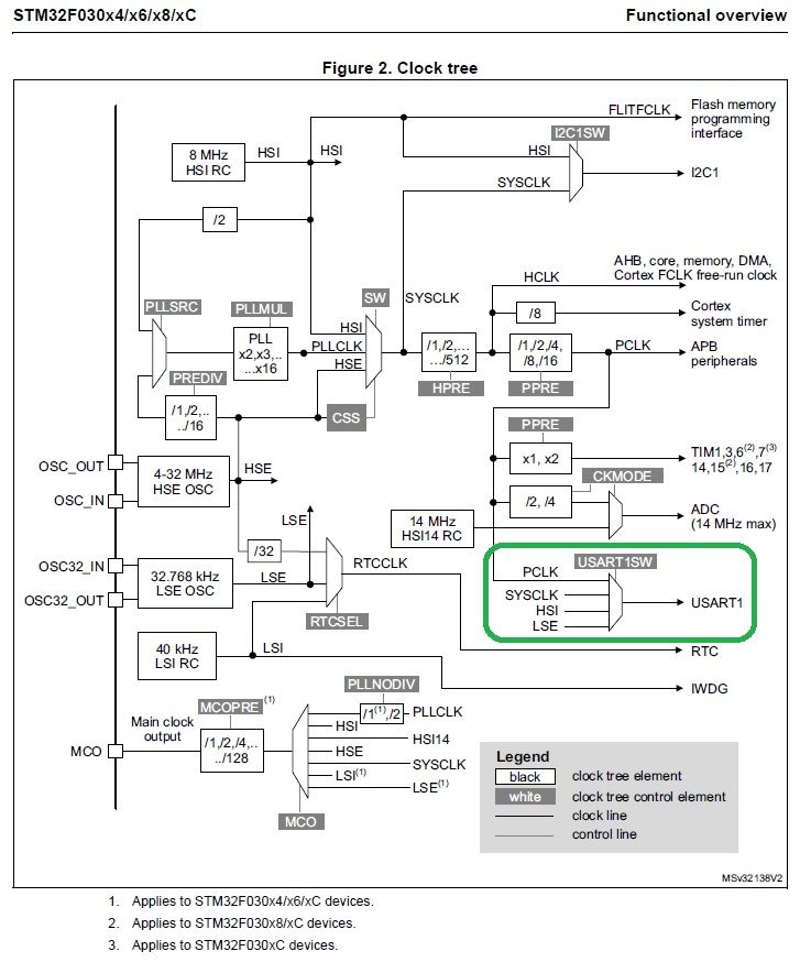

>>Am I doing something wrong or is the stm32f0xx_hal_rcc_ex.h file buggy?
The former. Review the clock tree diagram in the data sheet.
https://www.st.com/resource/en/datasheet/stm32f030c8.pdf
USART2 can only use the APB clock, you don't have a secondary option, and that's not furnished in the library accordingly.
2018-09-18 4:31 AM
Thanks Clive, as usual is a stupid mistake of mine.
