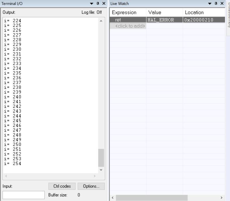

i'm trying to connect an STM32L072cz mcu ( as a master ) to a gas-module (as a slave) which 7-bit address from data sheet is "1100101b",
Wiring, pull-up resistors are placed correctly,
i'm trying to test if the communication is well established between the MCU and the sensor, but all I have is a HAL_ERROR from HAL_I2C_IsDeviceReady(),
NB : THIS CODE IS AUTOMATICALLY GENERATED FROM CubeMX
this is my code :

and this is the result after debugging,
2021-06-08 10:25 AM
HAL_ERROR indicates there is no slave device that responds to that address. More information is in the ErrorCode parameter.
Note that slave address are 7 bits (not 8) and should be left-aligned.
Recheck wiring and external pullup resistors. Put a scope on SDA/SCL to verify signal is sent correctly.
