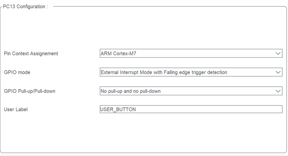

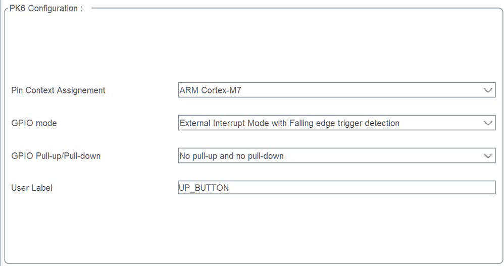

I configured 2 GPIO pins for EXTI falling edge interrupt. PK6 and and PC13. Just to be sure that one of them actually works.
Then I implemented HAL_GPIO_EXTI_Callback(uint16_t pin) function in my code, I run the project with the debugger, it starts, works, doing stuff, but when I press any of the hardware buttons nothing happens, the breakpoint on my callback isn't hit.

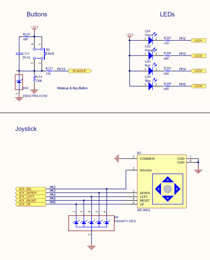

Here's what the documentation says about my hardware:

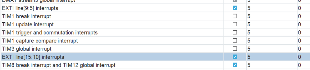

Here's what's set in Cube:
WAIT, WHAT?!
I've just checked the EXTI line[15:10] - it was not checked!
Now I'll just sit watching the paint dry as the project builds...
2022-06-13 9:52 AM
Yep. NVIC setting. Both lines work. Many tutorials don't include that step.
