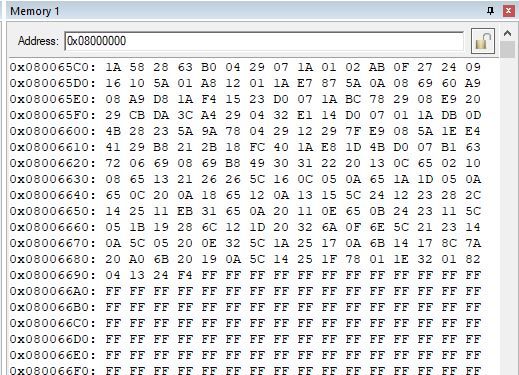

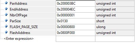

I am converting one of the my projects from F0 to G0. While debugging, when i come to HAL_FLASHEx_Erase line, it jumps to HardFault. I checked the memory, flash address is empty. I don't erase the program. Here is the some picture during the debug session and code.
What is the problem or my fail?

> //FLASH_EraseInit.Banks = 0x00;
Why is this commented out? You need to initialize this field.
> FLASH_EraseInit.Page = FlashAddress;
This is asking for a page, not an address.
Print out the values in FLASH_EraseInit at the time of the call to HAL_FLASHEx_Erase.

SOLVED...
First of all thank you @TDK you opened my eyes !
It is not PageAddress it is Page as you said so I added this code my function to calculate page number.
uint32_t FlashPage;
FlashPage = (FlashAddress & 0x000FFFFF) / 0x800 ;After that, I added this code below all of the flash operations.
FLASH_WaitForLastOperation(1000);And it SOLVED. Whole codes below for anyone who needs help.
