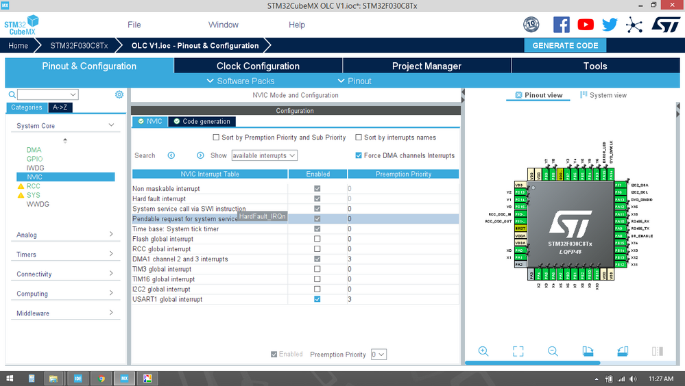

Do you have an interrupt that has higher priority than systick interrupt and happens continuously ? ( lower value means higher priority on Cortex M processors)
2022-01-05 1:02 AM
Systick interrupt having higher priority as shown in image
uwTick is increment also systick interrupt also call but still goes in infinite loop
