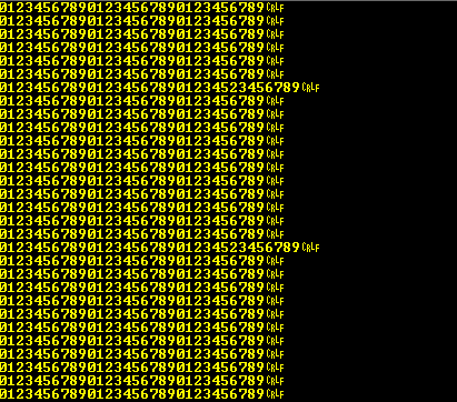

From the PC end the terminal shows an occasional either dropped or extended message:
I've pulled this test case out of a very large product code base down to a boot time example of CDC not working. It looks like the buffers are being overwritten or pointers are being corrupted on the next frame transmission, but there is nothing going on here except a loop of basic serial over USB transmission.

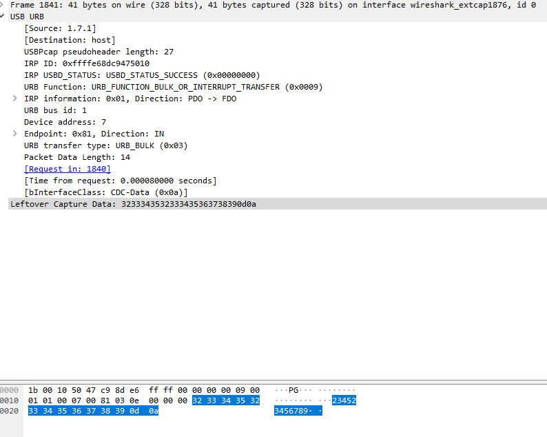

I would look at the USB traffic with wireshark or similar to see what packets on the line look like. That will show what the chip is actually sending.
2020-08-25 3:11 AM
I have captured with Wireshark and the data is being transmitted:
Packet data length shown in the USB log matches the corrupted data length.

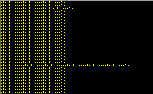

2020-08-25 3:20 AM
Also, there are some other patterns of corruption. Sometimes drops occur which I think this is giving an example of despite looking like there is 'more' data - I believe the longer line is because some got lost.
