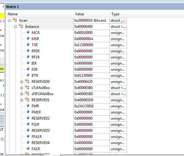

}here is picture of all reg contents

You must be running without a transceiver chip.
so therefore you need a pullup on the CAN Rx pin. <- your fix

Hello T J , ,
Thanks for replying . yes after pulling up rx line with 3.3k resistor the above problem got resolved. ,
