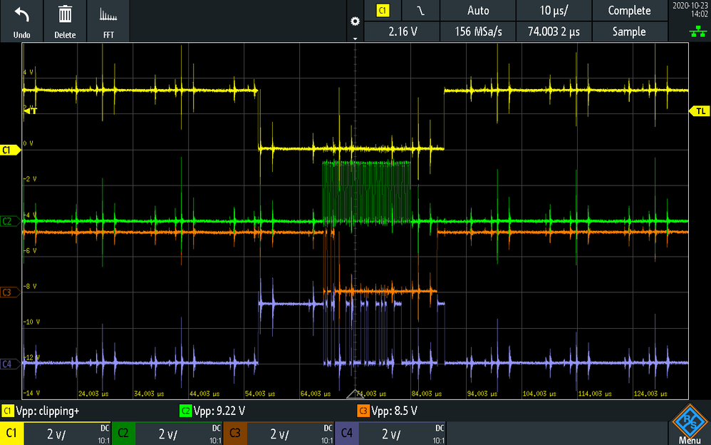

In cubeMX I found a setting with similar meaning to the one you proposed and it's called "Master Keep IO State", by default it was disabled. I set it to enabled, flashed.
in idle I could immediately a improvement (the steps on CLK/MOSI) are gone. That idle looks close to perfect.
With the motor active, the weird pattern is gone (thank you!) and we're left with a bit of excessive switching noise.
The results are better, though it is still a bit too high for correct operations, with too many CRC error on these SPI transactions.
here is what the screenshot looks like while the motor is active.
