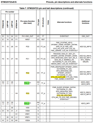

The closest matching report is this post hinting at possibly the weirdly unprotected analog switched PC2_C and PC3_C pins which are also present and used for DIR and NXT on the H723V.
There has never been activity on any ULPI pins coming from the STM after the initial HAL PHY setup with these damaged parts so damage within or behind the analog switch seems plausible that it does not see the NXT/DIR signals but could be something else. Once the Bus was stuck in a weird state with a high frequency signal only on the DP pin and NXT (ULPI was fine. Replacing H7 fixed it).

@Ultrawipf wrote:The closest matching report is this post hinting at possibly the weirdly unprotected analog switched PC2_C and PC3_C pins which are also present and used for DIR and NXT on the H723V.
Did you check you're using the right pins for the ULPI interface on the H723?
The issue likely arises only during startup, not during operation, and potentially is related to your SW configuration.
2024-07-30 5:09 AM - edited 2024-07-30 9:31 AM
Yes i am quite sure the pinout is correct as on the LQFP100 H723VG only the _C pins are available and it is generally working fine.
