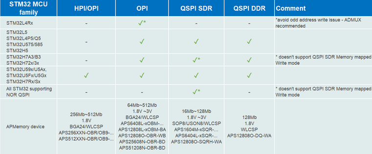

Adding few comments, if pin count is most critical we do have 128Mb QSPI DDR supported by STM32H72x/3x, improving BW at low pin count but this is WLCSP, so not most easy to assy.
Regarding Octal RAM all density (64Mb ~512Mb) can be supporting in BGA24.
Overview below:
Alex
