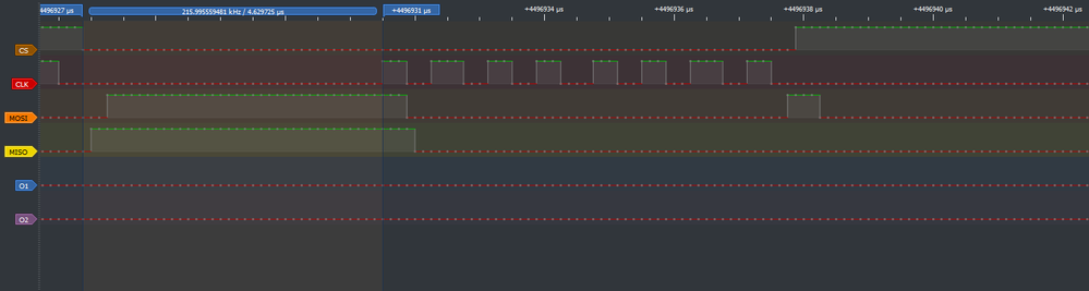

I use a STM32H723VGT6 as a master in a critical SPI communication with another microcontroller (critical because this mcu is very strict in the SPI timing, especially the time between CS and the start of CLK, and I cannot operate on the firmware of this MCU), this is my configuration:

This is the time used by SPI to start the transmission:
