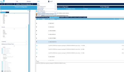

When I try to use X-CUBE-FREERTOS on H573 board, there is a warning sign and it is impossible to install.
How do I install X-CUBE-FREERTOS bundle for CubeMX?

You should first install the X-Cube-FREERTOS package from: Help > Manage embedded software packages > STMicroelectronics.

Thanks, login into the account fixed the problem.
