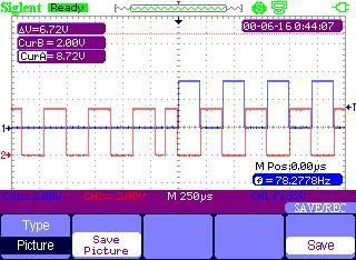

Enclosed please find the oscilloscope image of the Hi and Lo signal when I enable the Hi signal: Then due to this "stupid STM32H7 feature" the Lo signal will invert polarity, which of course is completely inacceptable for a nice power switch operation ... (this feature already destroyed one of my SLLIMM devices by effectively killing the dead time functionality...).
I think the STM32F4 did not have this feature ... no idea why the developpers sometimes seem to be so overly ambitius in creating new features when they "pimp up" older designs... . Stupid side effects sometimes then occur... .
