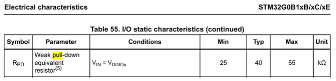

@TDK, just for clarification re. the STM32G0B1RET on a battery-supplied custom board:  the datasheet states that the pull-down resistor is weak, Table 55 lists around 40kOhm (see below). Can that cause a problem in Standby mode?
Also, one member states that in Standby Mode only RTC pins can drive low.
Please advise, I look forward to resolving this.
I don't see why that would cause a problem.
Not sure, no board here for me to test. Seems like it should work.
