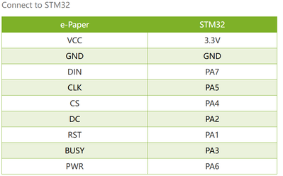

I am using a Nucleo32 F411RE to control a 2.9inch flexible E-Ink raw display panel from WaveShare. I use their circuit and a copied version of their code they have on their website. The code sends SPI commands over SPI1 of the F411RE and controls Chip Select and other gpio pins at GPIO port A. (PA1, PA2, PA3, PA4, PA5, PA6, PA7).

I don't have a schematic, but i have this:
from the display wiki: link
display datasheet: link

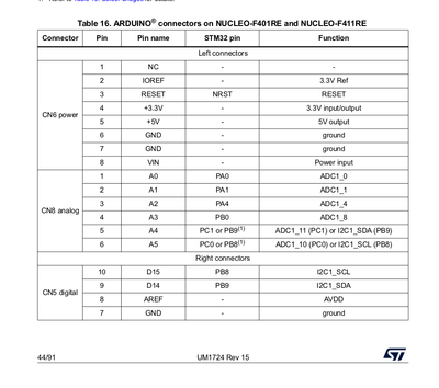

In addition, check the schematics of your board, if the pins you intent to use for SPI1 are connected to external circuitry that interferes with SPI.
The Discovery and Nucleo user manuals even used to have tables listing the use of GPIOs - check your pins are listed as "free".

2025-04-29 6:45 AM
No - in this case, I specifically meant the Nucleo schematics.And especially this document :
And especially footnotes to this table referring to the "Solder bridges" chapter !
