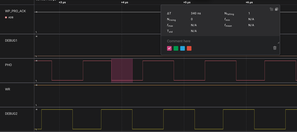

Using the logic analyzer:
Debug2 is the GPIO B13

TDK
Super User
335ns at 100 MHz is 33 ticks. That's about as good as you're going to get with this approach. Might be able to get it down to low 20s.
1) There's a 12-cycle delay for the ISR to fire on the M4 core.
1a) I suspect there are a few clocks of delay between the actual edge and the interrupt becoming pending.
2) There are additional flash wait states if the ISR instruction is not in memory.
3) You have a few instructions before actually setting the GPIO value. These use the same bus to communicate as setting the GPIO. Look at disassembly to see what it's doing.
4) The write to GPIO is not instant and will take a few cycles as well.
You can eliminate (2) by putting instructions in RAM. And you can affect (3), but only slightly.
