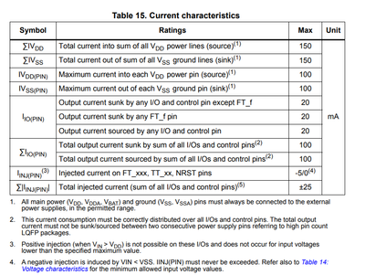

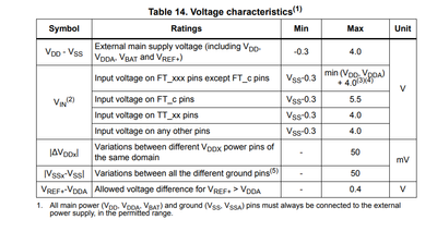

Dear @Jad ,
This is not possible and may destroy the Input structure and pad if the Absolute Maximum Ratings for the I/O are not inline with the datasheet. There are two conditions:
1) Vin Voltage :
2) Current - Last Lines
I highly recommend having bridge resistor divider to not exceed Operational VDD/VDDA for ADC from your 12Volts to the ADC input.
Cheers,
STOne-32.
