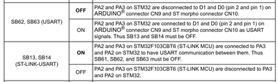

Where are you measuring the pins? PA2/PA3 are not connected to the headers by default. See the user manual. You will need to modify solder bridges to change this.

PA3 is going to be driven by the on-board ST-LINK/V2-1
You can find a schematic, and review that, from the CAD Resources tab on the product page.
