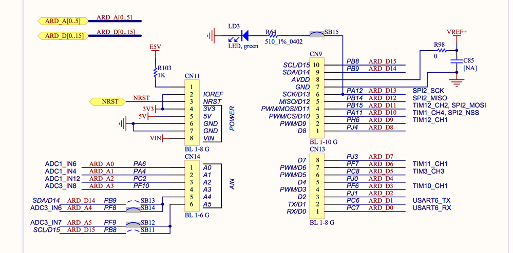

so far I have code below, but can't find the arduino pin : GPIO pin map ?
UM2033 Table 13 and Fig.33

, */2017-04-24 5:38 AM
In Tab13, search for lines where in Comment the name starts with ARD_. Fig.33 may be more comprehensive.

2017-04-24 7:59 AM
I'd maybe forget about looking for and usingthe BSP defines, you have the info you need on the schematic
ARD_D0 is shown as PC7

2017-04-24 8:40 AM
Maybe it would help if I knew the hardware address of say ARD_D0 ? Then I could work backwards through the libraries / code to see the relationship.
Anyone know where I can find that information ?
does GPIO_PIN_0 or hardware address 0x0001 = ARD_D0 ?
maybe i'm looking for the hardware address of ARD_D0 , ARD_D1 etc
'ARD_D0' is just an arbitrary name for a signal/connection in the schematics.
Down to the right of your image, at CN13, you see an instance of ARD_D0, and directly to the left, 'PC7'.
This PC7 is the actual GPIO pin of the MCU used to provide that 'ARD_D0' functionality.
You will find the pin name PC7 in the usual documents (as Jan suggested).
With time and experience, you gonna get use to read schematics.
