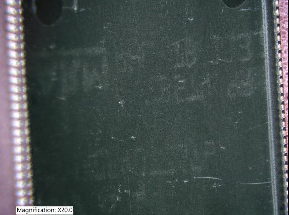

Please advise whether see before the below picture regrading the ghosting mark on the back of the part ? It is due to MFG fabrication matter which cause this issue.

Notice the ghost marking are mainly COO Philippines . Can you confirm this are acceptable

appreciate to receive some kind of response. please advise is this due to MFG fabrication and is it acceptable

Tell about how the device was handled before. Is in genuine out of the reel/tray? Or was is perhaps hand handled and stocked on another part. The ghosting looks like the some marking from another part.

Seems consistent with them being stacked post silkscreen or laser marking.

Do the parts function in the circuit? Does some cosmetic marking on the underside of the package interfere with use/operation?
Your in-bound acceptance process should be able to determine if you're willing to accept/reject these based on criterion you've set in-house.

If bought through legitimate channels you should be able to get lot traceability via ST directly.
The mirrored markings are consistent with top-side markings for STM32F407 parts manufactured at Amkor ATP Philippines

We have bought the parts in factory sealed pack. At the inspection area , we found this double imaging (ghost making) seen on the back of the chip
We have realize many of the batches has faced similar issue. We are reaching for your advise.
