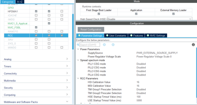

I tried to follow this tutorial: How to build an AI application from scratch on the... - STMicroelectronics Community , could not figure out how to enable NPU RIF, so i skipped it. I tried to debug using the FSBL main.c, the blue led did turn on, but i got the error in the screenshot when trying to launch application in FSBL main.c. Project: willisk0612/nucleo-getting-started

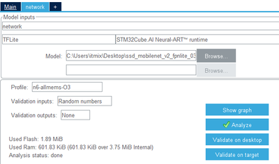

In .ioc → Middleware → X-Cube-AI → Configuration → Network,
make sure that Analyze is enabled.
If it’s not enabled, please re-import the AI model and enable it.

Go to RCC → Power Regulator and set it to 0.
