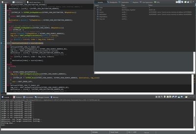

I tried to follow this tutorial: How to build an AI application from scratch on the... - STMicroelectronics Community , could not figure out how to enable NPU RIF, so i skipped it. I tried to debug using the FSBL main.c, the blue led did turn on, but i got the error in the screenshot when trying to launch application in FSBL main.c. Project: willisk0612/nucleo-getting-started

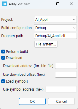

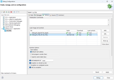

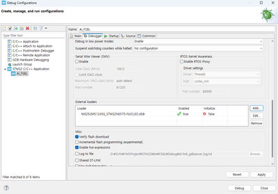

Then, in the debug settings, try the following configuration:
external loaders -> Add -> MX25UM51245G_STM32N6570-NUCLEO.stldr
Startup setting
Load Image and Symbols -> Add
Project: {YourProject}.Appli
Build Configuration: Debug
Click OK
Try applying the above settings as well.
@silpiode Thanks for the answer. I tried to implement your project, but i got no response from the COM port or LED still. Since i have no idea what may be causing the error, i tried debugging with the same config as you mentioned. The debugger hung at
SCB_EnableDCache();
in AI_FSBL/Core/Src/main.c. Tried to uncomment that line, the debug pointer got stuck at
if (BOOT_OK != BOOT_Application())
Again, i do not know if debugging is possible on this project, did you get the debugger to work? The tutorial used DK external loader in cubeprogrammer, i think this screenshot was from the previous tutorial he did on the STM32N6 DK board, so I switched to STM32N6 NUCLEO external loader.

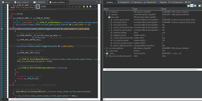

@silpiode i got the same behaviour. But when debugging the application, my pointer seems to get stuck at this loop in app_x-cube-ai.c:
do {
			// Execute first/next epoch block
			ll_aton_rt_ret = LL_ATON_RT_RunEpochBlock(&NN_Instance_Default);
			// Wait for event if required
			if (ll_aton_rt_ret == LL_ATON_RT_WFE) {
				LL_ATON_OSAL_WFE();
		} while (ll_aton_rt_ret != LL_ATON_RT_DONE);
It seems like LL_ATON_RT_RunEpochBlock(&NN_Instance_Default); expression always evalutes to LL_ATON_RT_WFE
The tutorial mentioned that we should add LED blinking after MX_X_CUBE_AI_Process(); to make sure it does not get stuck during inference. But that seems to be my problem if i am not doing anything wrong?
