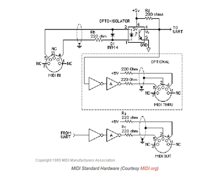

you have to isolate the cpu pin ALWAYS !
keep to the 35 y old standard:
https://www.midi.org/specifications-old/item/midi-din-electrical-specification
https://learn.sparkfun.com/tutorials/midi-tutorial/hardware--electronic-implementation
what i would do: invert the cpu out signal, put an nice mosfet as output , ie IRLML6344 + 220 or 10 ohms (depends: you drive 5V or 3v3 pos.supply );

2023-11-28 10:35 AM
Ok thanks. I had read the spec however was concerned about the potential for shorting of cable with only 10ohm and 33ohm resistors in place. ( i'm using 3.3V source ). Using the mosfet as you suggest would allow me to stick to the spec and also isolate the uC, thanks.

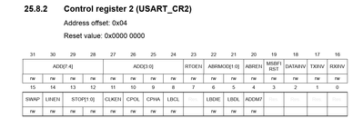

and dont forget to invert the uart output, on F373 can use:

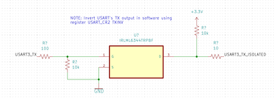

2023-11-28 1:44 PM
Have I wired this up correctly to isolate the STM32F373's USART TX?
2023-11-29 12:17 AM
yes, perfect !
