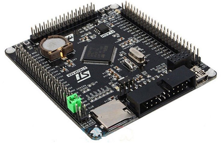

The development board I'm using is STM32F407VET6 Black Board.
