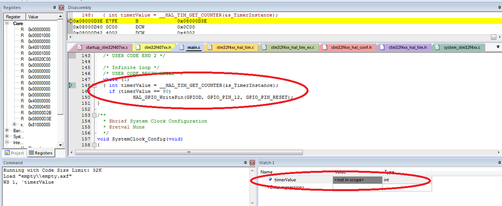

2019-01-01 4:57 AM
What do you expect? The program conveys an idea, Turns on the LED, and some time later turns it off, when the count is exactly 10. Likely to be fairly brief in human terms.
===> yes thats the idea: at the begining of thre program, the led could be turned on and after, a number of timer count, i want to turn it off. But, it seems i have problem with timer's configuration . See the attached picture, it seems i have problem with the timers count using this funtion: __HAL_TIM_GET_COUNTER
2019-01-01 4:58 AM
2019-01-01 9:30 AM
Perhaps don't fold the lines over each other. And use a "static int" so the variable is held in memory, not a register, and then break-point on the line of the comparison.
Use ">= 90" so if you miss the exact tick you still catch it passing.
2019-01-01 10:24 AM
Hi clive,
Is that your proposition:
while (1)
{ static int timerValue ;
timerValue=__HAL_TIM_GET_COUNTER(&s_TimerInstance);
if ( timerValue >= 90)
HAL_GPIO_WritePin(GPIOD, GPIO_PIN_12, GPIO_PIN_RESET);
But it fails again, the led didnt turn off!
2019-01-01 10:43 AM
Try looking a the TIM2 registers via the Peripheral View, drill down via the "Peripherals" menu in the debugger.
Is this an STM32F4-DISCO board?
Perhaps try toggling the GPIO in a loop and single-stepping that?
