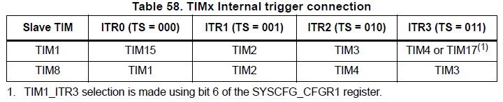

Check the Reference Manual for internal trigger mapping that would get a Master TIMx_CHx to fire a slave

The ''one pulse mode'' does not seem to solve my problems.the period of ''delay''+''pulse'' is the same for all channels on the same timer.I need to have the ''pulse'' fixed to 100ns+-10ns and be able to change the ''delay'' for each channel separately.Is there a workaround for this?I have also tried to trigger timer8 from timer2 channel 2 (capture compare) but are not able to do so.It is easy to setup timer8 to trigger on the timer2 output. But I can only find settings to generate trigger signals from timer2 output compare. I need to trigger on input capture.TIM_TRGOSource_Reset TIM_TRGOSource_Enable TIM_TRGOSource_Update TIM_TRGOSource_OC1 TIM_TRGOSource_OC1Ref TIM_TRGOSource_OC2Ref TIM_TRGOSource_OC3Ref TIM_TRGOSource_OC4Ref Is there any other way?which chapter exactly is the ''internal trigger mapping'' ?2015-06-03 8:20 AM

You can pick the trigger output on the master, and the source timer on the slave.We’re moving the ST Community to a new platform to give you a better and more reliable community experience.
