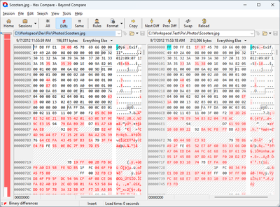

As I said, do what to do with linker file and do the HEX file comparison. I suggested Beyond Compare as it's an efficient tool in HEX compare: https://www.scootersoftware.com/v5help/viewhex.html

"After modifying the linker file, I want to see these changes reflected in the HEX file" do a diff between the HEX files using for example Beyond Compare tool. It can do HEX file comparison.
