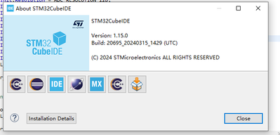

Hi Souhaib
The CubeIDE version is 1.15.0 but 1.14.0 seems have the same problem.

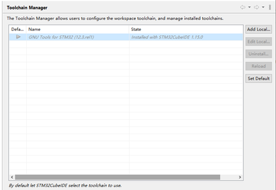

The toolchain is default. I try to append a c-flag '-gdwarf-2' but still not working.
The operation system is win10

Hello @yansli
It seems that the issue is related to the upgrade to GCC 11,
I suggest that you use the GNU Tools for STM32 (10.3-2021.10)
