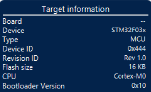

2024-07-12 8:10 AM
Show , whats STM32CubeProgrammer telling :

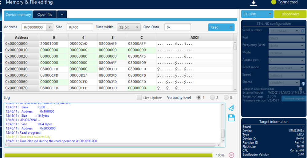

2024-07-15 12:19 AM
Afte connect to STM32CubeProgrammer this is what i able to gat
2024-07-15 12:22 AM
No I have chack the device it is the oragnal demo board
2024-07-15 12:34 AM - edited 2024-07-15 12:40 AM
Good !
so we see:
...connected to F03xx , ID 0x444 , rev 1.0 .

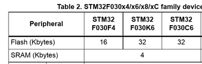

Flash 16KB -> but you have in IDE flash size 32KB ! So someone wrong here...sure, you set it to the version of chip, you really have here (16KB) ?

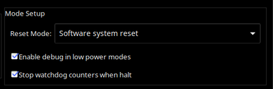

or - if you set in IDE correct F030F4 for your project, set connect "software reset" -- but debug still not working:

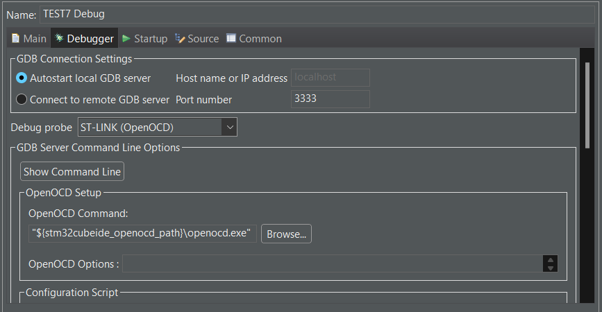

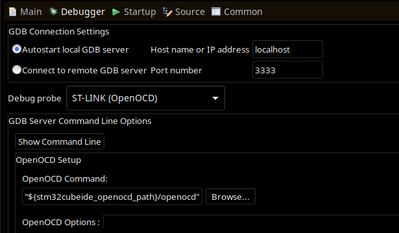

try using the open ocd debugger, just set it in debug settings:
