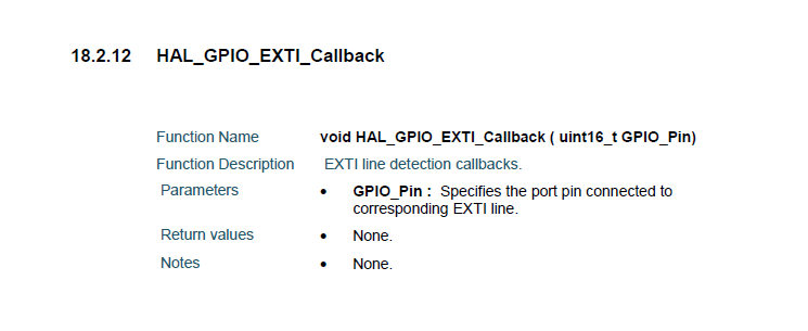

HAL provides a callback that you can use:
This routine is called when the HAL interrupt handler is called (the code you are looking at in the *_it.c file). If you write your own routine like this:
void HAL_GPIO_EXTI_Callback(uint16_t GPIO_Pin){
if(GPIO_Pin == GPIO_PIN_0){
do stuff;
else if (GPIO_Pin == GPIO_PIN_1){
do other stuff;
it will do what you want. This is in the GPIO section of the HAL reference manual. I took the one from the F0 family but they are pretty much all the same.
You do not need to touch the interrupt code in the *_it.c file. It will do what you want.
