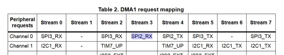

The problem is that the interrupt of the RX DMA is never generated.
There is no problems for the Tx interrupt. The interrupt is generated periodically when the transfert is complete.
I don't know where this problem could come from.
I used the same functions on a other target (stm32f411 ) and the I2S3 works well with DMA in full duplex mode.
thanks you for your help

Sorry for my basic English.
By remplacing SPI2 By SPI3 , i mean : In the cubeMx interface, I disable I2S2 . I enable I2S3 in full duplex master mode. And in the configuration tab > I2S3 > DMA Settings , I create two DMA request (Tx and Rx) with the default Dma/stream/channel/direction. and i choose Mode circular. increment memory only. And with the I2S3 in full duplex (SPI3_Tx & I2S3_ext_rx), when i start the DMA transfert with HAL_DMAEx_MultiBufferStart_IT( ... ) everything works. My callback : hdma_i2s3_ext_rx.XferCpltCallback hdma_i2s3_ext_rx.XferM1CpltCallback hdma_spi3_tx.XferCpltCallback hdma_spi3_tx.XferM1CpltCallback are called. I can set breakpoint in the two DMA_Stream_IRQHandler() and i can see the program stopped in the two. But when configure my code with I2S2(SPI2_tx and I2S2_ext_rx). I can not use the I2S2_ext_rx. I check my hardware, nothing looks strange on my I2S2_ext_rx pin. And i have this problem on my two boards. Thanks for your help.We’re moving the ST Community to a new platform to give you a better and more reliable community experience.
