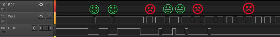

I'm using the FSMC in the STM32L4, but can't figure out how to disable ''burst'' writes.
By this, I mean that multiple writes happen within a single CS. When I do multiple writes in a row to external memory, sometimes these writes get ''grouped'' into a single chip select. If I add some __NOP()'s or enough instructions between, the writes occur correctly. Here's my configuration, which is basically taken straight from the CUBE example code:hsram.Instance = FMC_NORSRAM_DEVICE;

When I do a bunch of writes in a row, here's what I get. (I've inserted some __NOP()'s toward the beginning to show you what it should look like.)
FMC_WRITE_BURST_DISABLE.

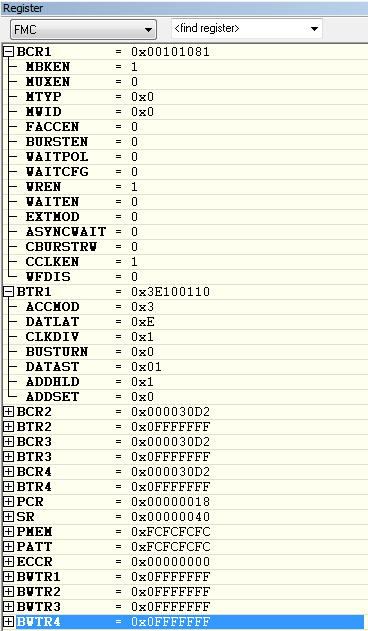

Post the relevant FMC registers content.
Are you sure your LA can capture a short CS pulse? Try decreasing the system clock without changing the relative timing, just to see the result.JW

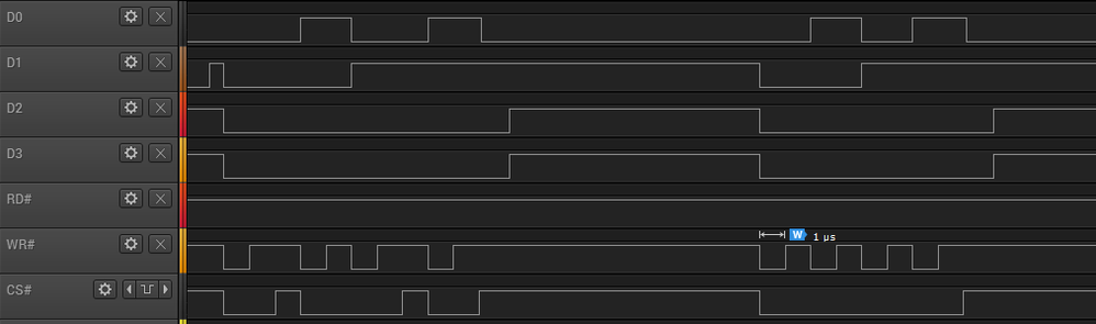

Hi Jan,
I slowed the clock speed down to 1MHz (it was 48MHz) and I still see the same issue: (On the right side, I'm writing out: 0, 1, 2, 3 as you can see on the D[3:0] data lines. But they all happen within a single chip select. My logic analyzer is sampling at 100MHz, so 100x oversampling for this case.)2016-02-29 11:00 AM
Edit: It seems like the above behavior is the way it is supposed to work. (It's just not how I envisioned it in my head, based on the timing diagrams presented in the datasheet/reference manual).
I think CS staying low for multiple writes should be fine for my application.2016-02-29 11:48 PM
