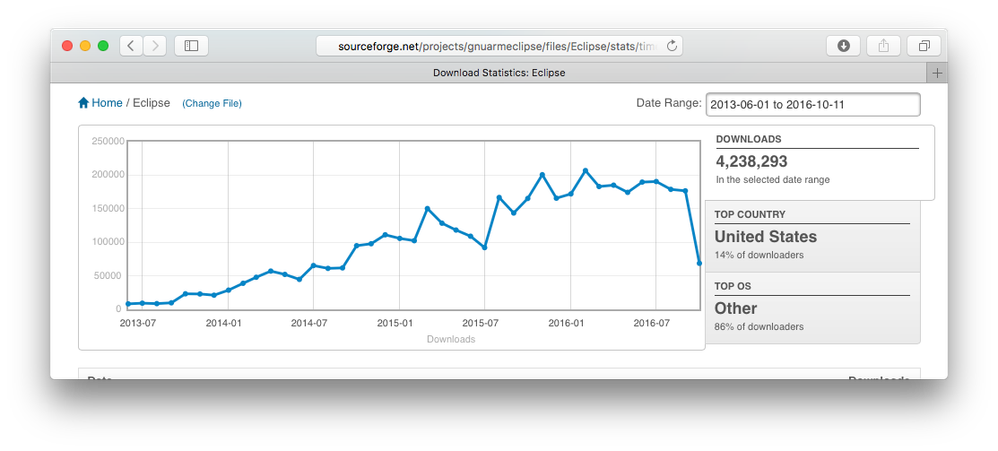

Thank you, Marcello.I hope this is just the first step, and some day CubeMX will also generate GNU ARM Eclipse projects.It is curios that although GNU ARM Eclipse supported from the very beginning ST devices, ST never considered the opportunity to use this open source project.Freescale did this, and KDS is based on the GNU ARM Eclipse build and debugging plug-ins, Infineon did this and DAVE uses the GNU ARM Eclipse debugging plug-ins, Somnium, and many more used the GNU ARM Eclipse in various ways.It is a pity that ST did not sense the opportunity...According to SourceForge, the project accounted more than 4.200.000 files downloaded; perhaps this might help raise some attention to responsible ST guys.2017-01-15 12:09 AM
