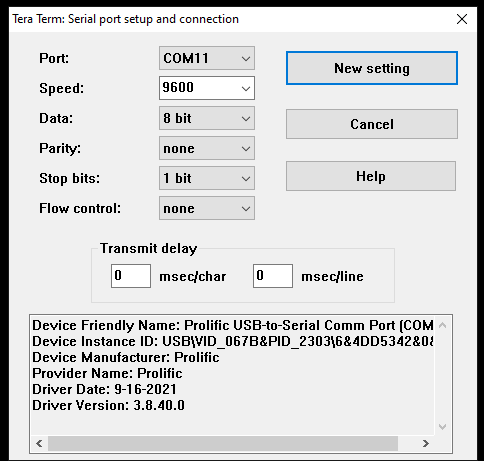

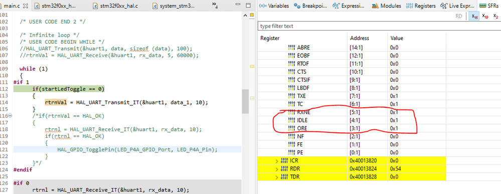

With the above code I'm trying to send a character from STM32F030F4P6 to PC, but the transmitted character is not received in PC teraterm terminal. I observed the RXNE register is set and also framing error and overrun error is set. My teraterm configuration below:
Could you people please explain me why the RXNE and ORE bits are set also the reason for setting FE bit as well.
Thanks in advance!!!

Do you have means to test if your Prolific adapter is working properly? I had a Prolific "clone" that was not working properly with the Prolific driver. (Prolific took some measures against Chinese counterfit). You could try to echo on your board by connecting TX to RX or do the same on the PC side to narrow down the problem to the PC side or the MCU side.

Framing and overrun are receiver errors. Framing means the USART did not see a clean start bit to stop bit data frame. Overrun means the receiver has incoming data but the receive data buffer has not been cleared. To clear these errors read the USART status, then the data register. If the errors persist you have incoming noise creating false triggers for the USART receiver.
Do an end to end test of your board first by connecting the RS-232 TX pin to RX pin, instead of to a PC. Program a test to send one character and verify you can receive it (after clearing any RX errors). If you still get errors you have a hardware problem.

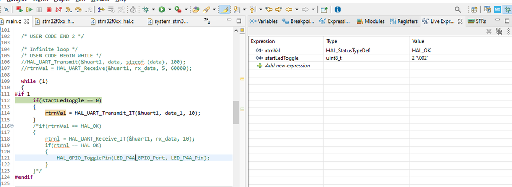

Hello @Community member Thanks for your reply.
I have made the loop back connection in my HW, (Tx to RX) and checked for sending a one char and there are no FE and ORE, but while trying to send more than one characters observed ORE.
After that I have changed the code to transmit one char to tera term but I still observing the garbage value in the tera term. I have include the code below, in this the code I have tried to transmitting more than one character. But still seeing the RXNE and ORE bit are set, can you please guide why these receive operation bits are set even nothing is transmitting from the tera term.

There are a lot of issues with that code. For example, HAL_UART_Receive_IT should not be called repeatedly. You need to wait for the previous transaction to complete before starting a new one.
As mentioned, ORE and FE are receiver errors. Perhaps you start receiving in the middle of a byte, or perhaps the UART receives data while it is not ready due to the previous call being complete. The Reference Manual is very specific about the causes of these errors.
2022-01-03 1:00 AM
Hello @TDK Thanks for your reply. Apologies for attaching the code with the reception functionality, here the discussion is about transmission, not for reception of USART. Now modified the clock source as external 8MHZ and even adding a delay of a sec between the character transmission but no improvement. Please see the attached code below
