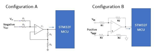

2021-11-12 4:47 AM
Do you mean that I have to use an OP-AMP Circuit as shown below?
Please let me know.
2021-11-12 5:17 AM
Yes, except in the first schematics the divider should IMO go to positive VREF.
2021-11-12 6:30 PM
Thank you very much.
2021-11-12 10:06 PM
Alternatively, depending on the signal properties, an AC coupling with serial cap followed by mid voltage could be an option.
2021-11-13 10:53 AM
For better quality, consider using an OPAMP. It will allow you to add Vref/2 offset (mandatory), make low pass filter (to avoid aliasing) and drive with low impedance the ADC input. Otherwise, as stated by Jan, it will be difficult to keep a short sampling time vs relative low impedance of mux/sample and hold of STM.
