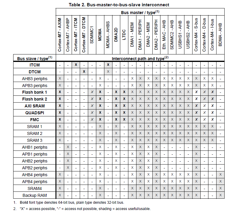

Hi, I use STM32H745XIH6
I check datasheet of MCU, the FMC 2 cpu can access.
