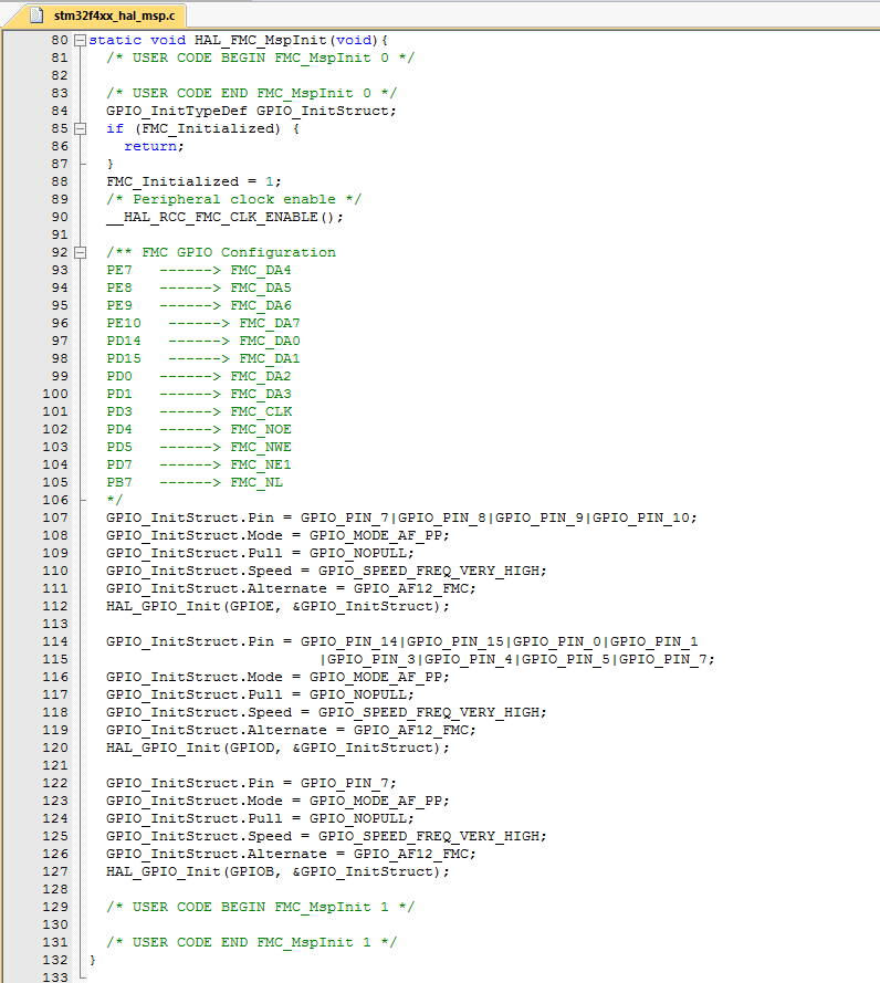

Itested with the same board and CubeMX version (4.1):The
FMC clock is enabled and the
GPIOs are initialized in STM32F4xx_hal_msp.c file.
Please, try to share your ioc file to check your issue.

If I look into STM32F4xx_hal_msp.c then I see no Clock or GPIO init, only Priority settings.
