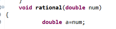

if I give argument like above picture infinity loop stops working
but if I give the number num inside function the instead of giving argument then its working fine.
If I give int instead of double as the datatype of argument then also it's working.
Please help

Oh, sorry, stm32f411re is the microcontroller. I don't know how to configure compiler. It has the default setting. Double is working if i give the value inside the function. When I'm debugging and running the code the code runs successfully but infinity loop stops.

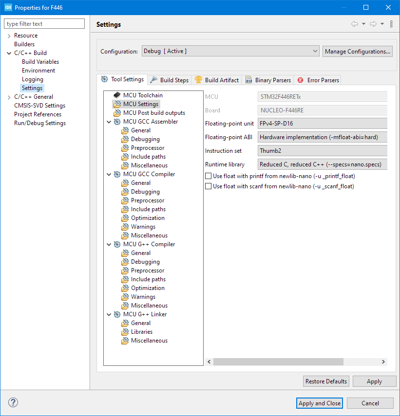

Is the FPU enabled?

Right click on the project name / Properties / C/C++ Build / Settings
Tool Settings tab, MCU settings line
