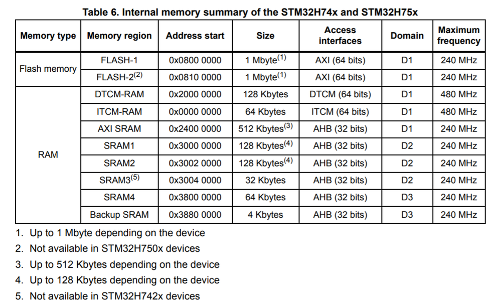

We found that the flash banks do not simply "overlap" with each other. You might think so though, by looking at the memory regions in the picture below, both FLASH-1 and FLASH-2 are address-wise contiguous.

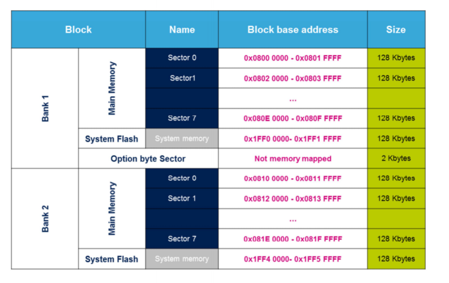

The problem with using the two flash banks as one contiguous bank seems to lay in the organization of the internal blocks.In this screenshot you can see the flash memory organization. The last 128Kb + 2Kb are used by the "system memory" and the option byte sector. Meaning that effectively the two banks are non-contiguous, explaining why all of a sudden the growing binary would not fit anymore.

They are contiguous. Bank 1 ends at 0x080FFFFF and bank 2 starts at 0x081000000. "System flash" in the table is at a different address, not between them.

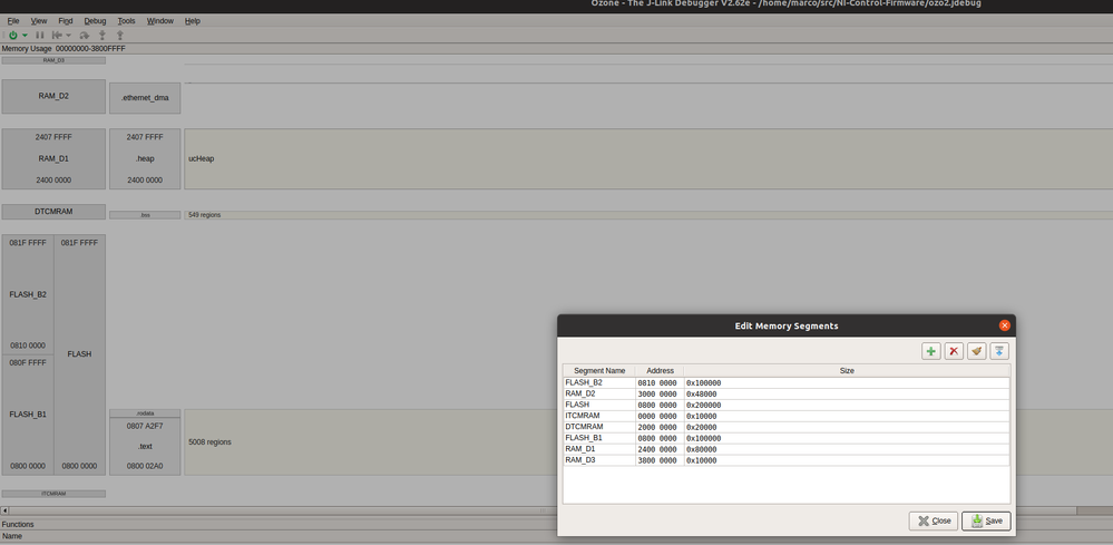

}This is what I've setup in Ozone too (using in conjuncture with Seggers J-Link, adding FLASH Bank1 and 2 for good measurement):

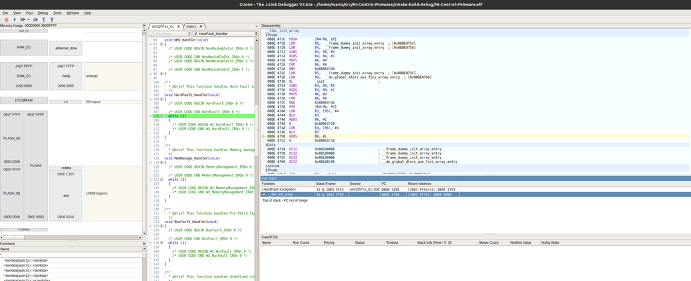

Running this code leads to the following:
This is clearly not from a bug in our code, but a problem that rose (as this is not a problem with the F767, more about that a bit later).

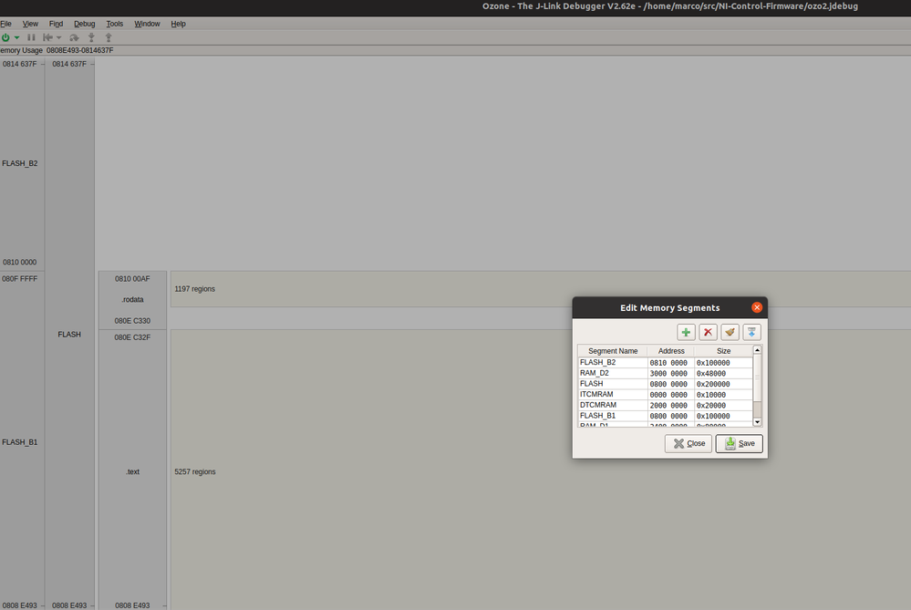

Now, I change 1 thing, not in code, but in compiling: I will add O1 for code optimizations. The above is done with O0 (no optimizations at all).
Then the result is like this:
and now, when I start the code, it works perfectly fine!
