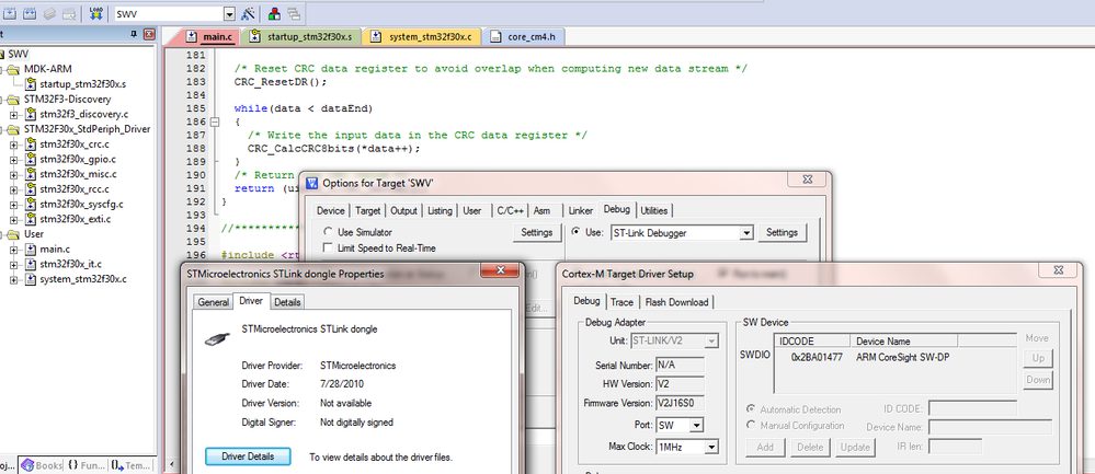

Hi chendy,
Please make sure to have the following settings on keil uVision:
On window:
You should find an ID similar to:
Caution
: Be sure that the ST-Link utility tool is disconnected from your device.Khouloud.

2017-01-09 8:38 AM
The same way you'd program it if it were just the DISCO board, go into the options for your project and select the ''ST-Link'' in SWD mode for the Debugger/Utilities Pane, and in the Settings for the debugger picking the STM32F0 Flash Algorithm
I'm sure Keil also has documentation and app notes if you care to review
2017-01-17 6:29 AM
Caution
: Be sure that the ST-Link utility tool is disconnected from your device.Yep was just this, sorry everybody. Works fine when St-Link utility is not running ofc!
