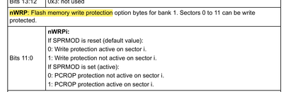

Write 1 to the relevant write protection bits in the option bytes. This can be done in code or in STM32CubeProgrammer.
You can undo this to write code again.
If you want to permanently prevent access, set RDP level 2, which is quite restrictive and is irreversible.
