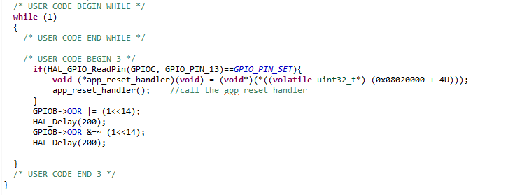

Hello, I tried following your advice but it didn't work so I took some code that I wrote hope you can help.
This figure is the code in my first program, when I press the button it jumps to the address 0x08020000.

If you notice anything let me know, thanks a lot.
