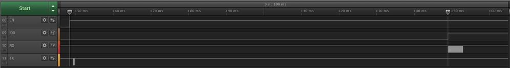

If it gives any clues this is the current communication I am seeing between the ESP32 and STM32.

What's the RX/TX on the trace? Which is the ESP32 output, and which the STM32 output?
