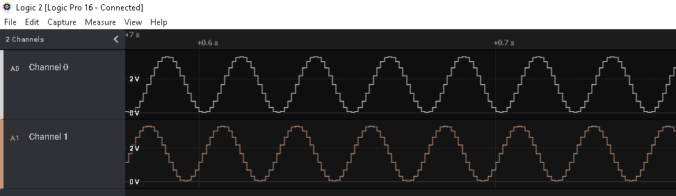

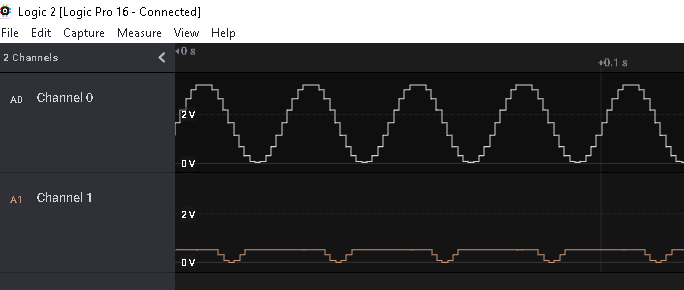

DAC restricted to 0.5volt on a stm32L432 when you add a gpio_output to any PB
PGood.1
Associate II
DAC restricted to 0.5volt on a stm32L432 when you add a gpio_output to any PB and appears to be the line __HAL_RCC_GPIOB_CLK_ENABLE(); added to MX_GPIO_Init
with
 /* GPIO Ports Clock Enable */
 __HAL_RCC_GPIOA_CLK_ENABLE();
 //__HAL_RCC_GPIOB_CLK_ENABLE();
void MX_GPIO_Init(void)

waclawek.jan
Super User
What hardware is this, a "known good" board such as Nucleo or Disco, or your own? Do you measure "Channel1" on PA5 or on some other pin? What else is connected to that pin?
Or anything else on GPIO BANK B.
Check for inter-connnects, shorts. Netlist?
uint32_t wave_time; // global or auto/local ?
From the old unrelated thread.
https://community.st.com/s/question/0D53W00000Po8KSSAZ/stm32f20x-adc-has-voltage-output
"Having a look at the schematic it looks like there are 2 jumpers on the back of the board SB18 Connect D4 to A4 and SB16 Connect D5 to A5 if you want to use A4 (PA5) as an analogue output or a5 as an ADC these jumpers need to be removed"
Signs point to a NUCLEO-32 board with L432
